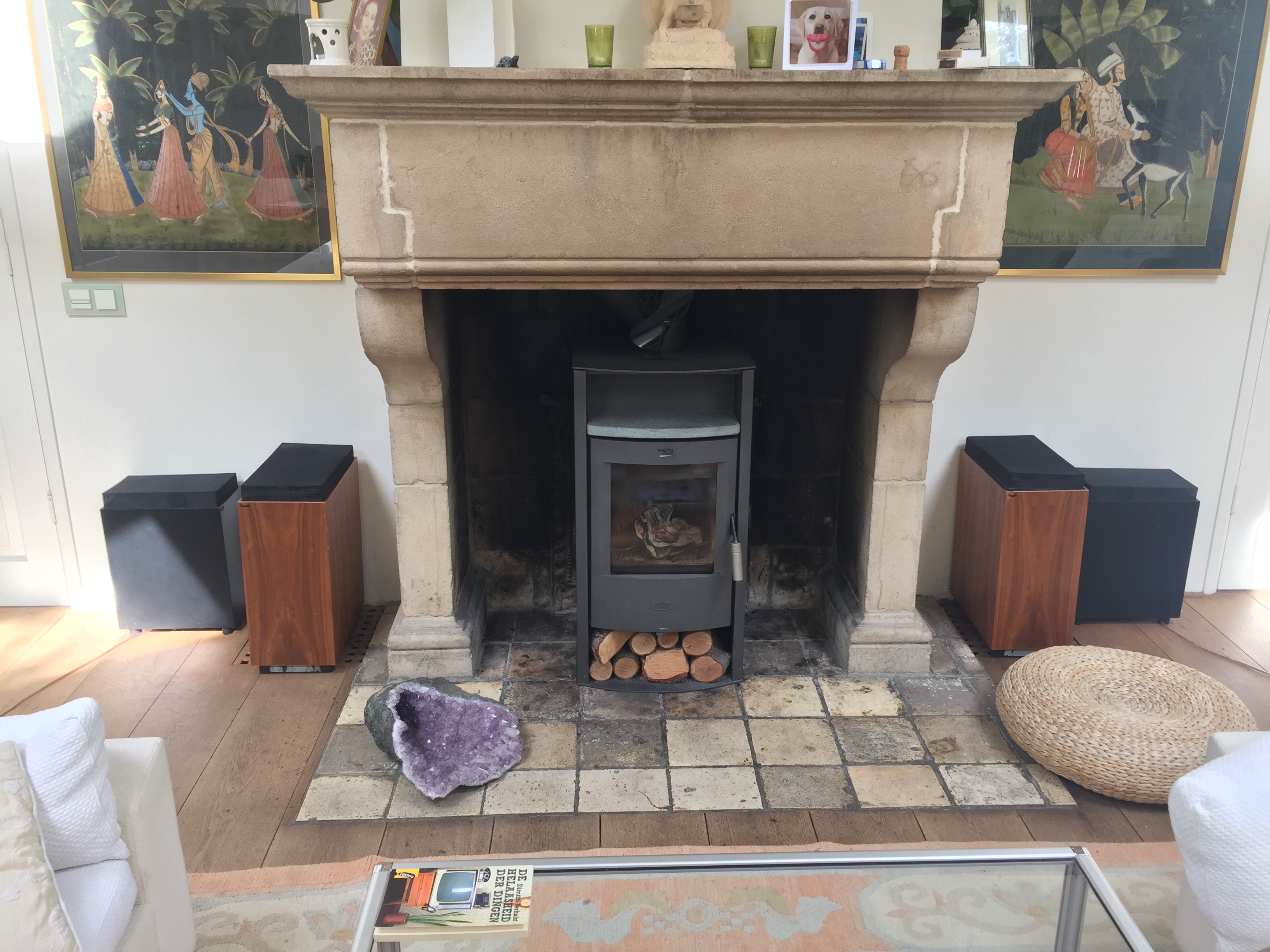

Here they are (not connected or positioned yet : it's going to take a while to get around to it)... but I have a question about long or short side against the wall (in the photo, I'd say the OA-12s have long side against the wall) : as far as I can see, the speakers were designed to have the short side to the wall, with the mid/bass unit nearest to the wall. With the OA-12s, I notice the sound is slightly different depending on orientation, but I have yet to say one way is better than the other.
Does anyone have a clear opinion on this, please ?

OA12, OA14, OA116 and OA2212 are all supposed to have the short side against the wall. But you are allowed to do what ever you find the best.
I also think the big fire place between the speakers will have a (negative?) influence on the sound.

It does indeed and conventional speakers need to be pulled out so that the imaging is not affected. I will experiment with the OA-14... I tried the OA-12 quite close to the fireplace with the Left and Right units swapped around, such that the main drivers were firing towards the side walls. Not a "correct" sound and weird stereo image, but quite pleasing nonetheless... although I did revert to a more conventional layout.STDI! wrote:I also think the big fire place between the speakers will have a (negative?) influence on the sound.
I am thinking how to integrate the two subs & first I will try driving them from my main stereo amp (either a Luxman L-210 or Yamaha CA-800 II at the moment), via "Speakers 2". I will also try running just a single set of speakers cables to each OA-14, then onwards to the subs, which will be at the end of each sofa firing towards the OA-14. The end of sofa location reduces the sub output considerably - desirable in my experience in this particular room.
Connecting in this way, I will also be running both subs and OA-14 full range, as I will be bypassing the sub crossovers. This appeals to me in theory - whether it works in practice remains to be seen (I can reduce the sub output further by restricting their ports).

You can go wherever you want! I’ve tried different ways, but always come back to the original set-up (the short side to the wall). Different rooms will make this speaker sound different. For instance I´ve had my OD 11:s stuck in a shelf (bottom to the wall), once on a small stand, but they always came back on to the floor. You will get very different ”kamfiltereffects” with these speakers depending where (and how) they stand In a room. Don´t forget the ceiling. The higher, the more distance between them is a must. That´s my experience. I let my OA 50 stand more than three meters apart. My OA 12:s is 2,5 m apart. The ceiling is about 2,5 m (OA 50) and 3,8 (OA 12). I have no fireplace as big as yours. Personal preferences are of course important (I like Lars Erstrands vibraphone high up in the air on the ”Jazz at the pawnshop”- record).
I think your room is rather special. For me it looks like a nightmare.
The subs? Well, do as you want. It looks like the bass will bounce all around and I am not surprised that you must use a sofa to reduce the output. I think the OA 14´s will sound strange in your room (but that´s me). All depends on what you listen to and what your personal preferences are.

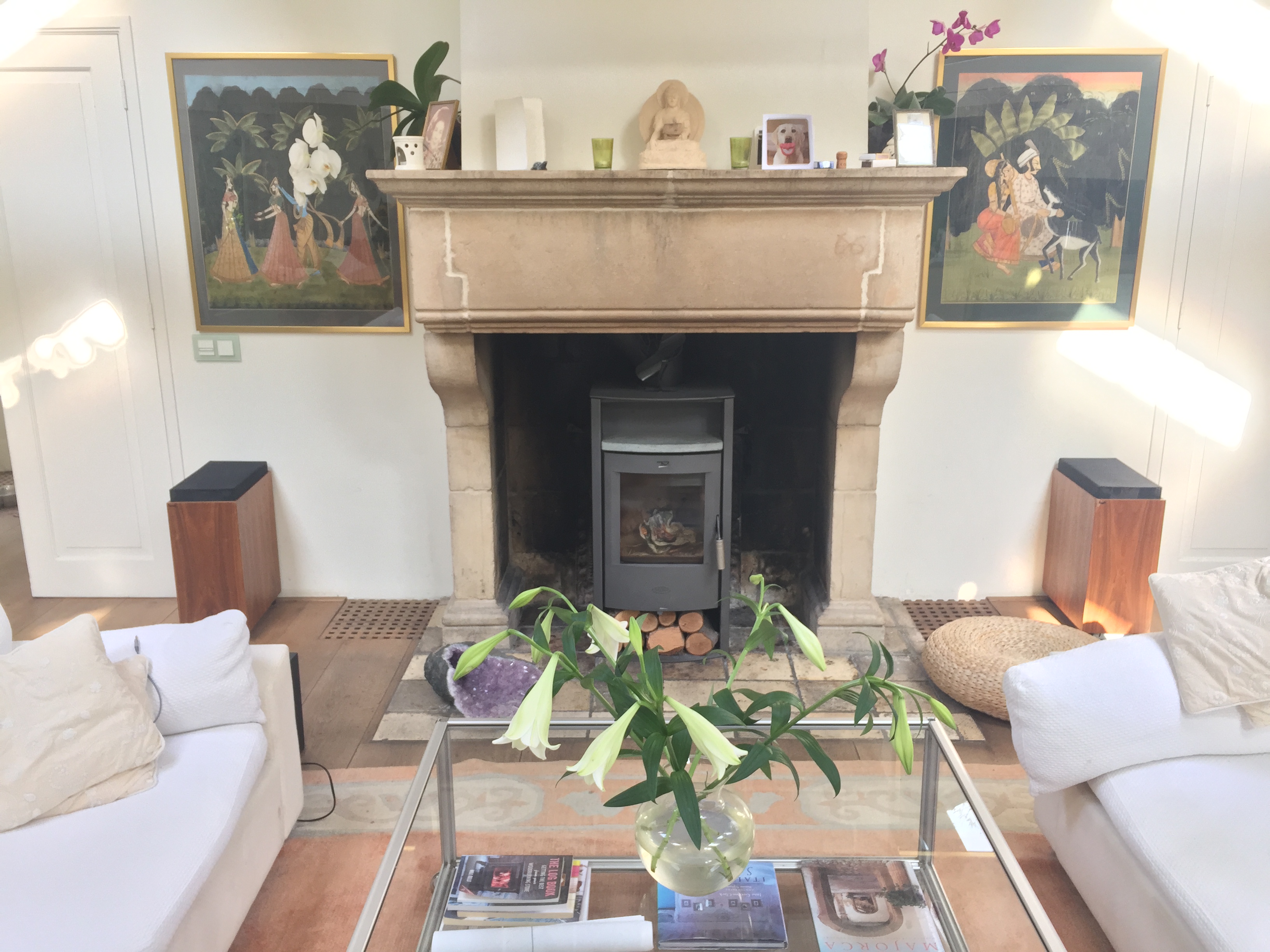

The OA-14 are now installed and singing... with the help of a sub (sub #2 requiring amplifier repair before introduction) :
In some ways better than the OA-12, but in others slightly less so.... and my guess is that this is because I am dealing with two very old ladies (the loudspeakers, not my ex-wives...). However, I LOVE the way they look : their size fits the room perfectly (having grown up in an architectural family, aesthetic considerations are important).
