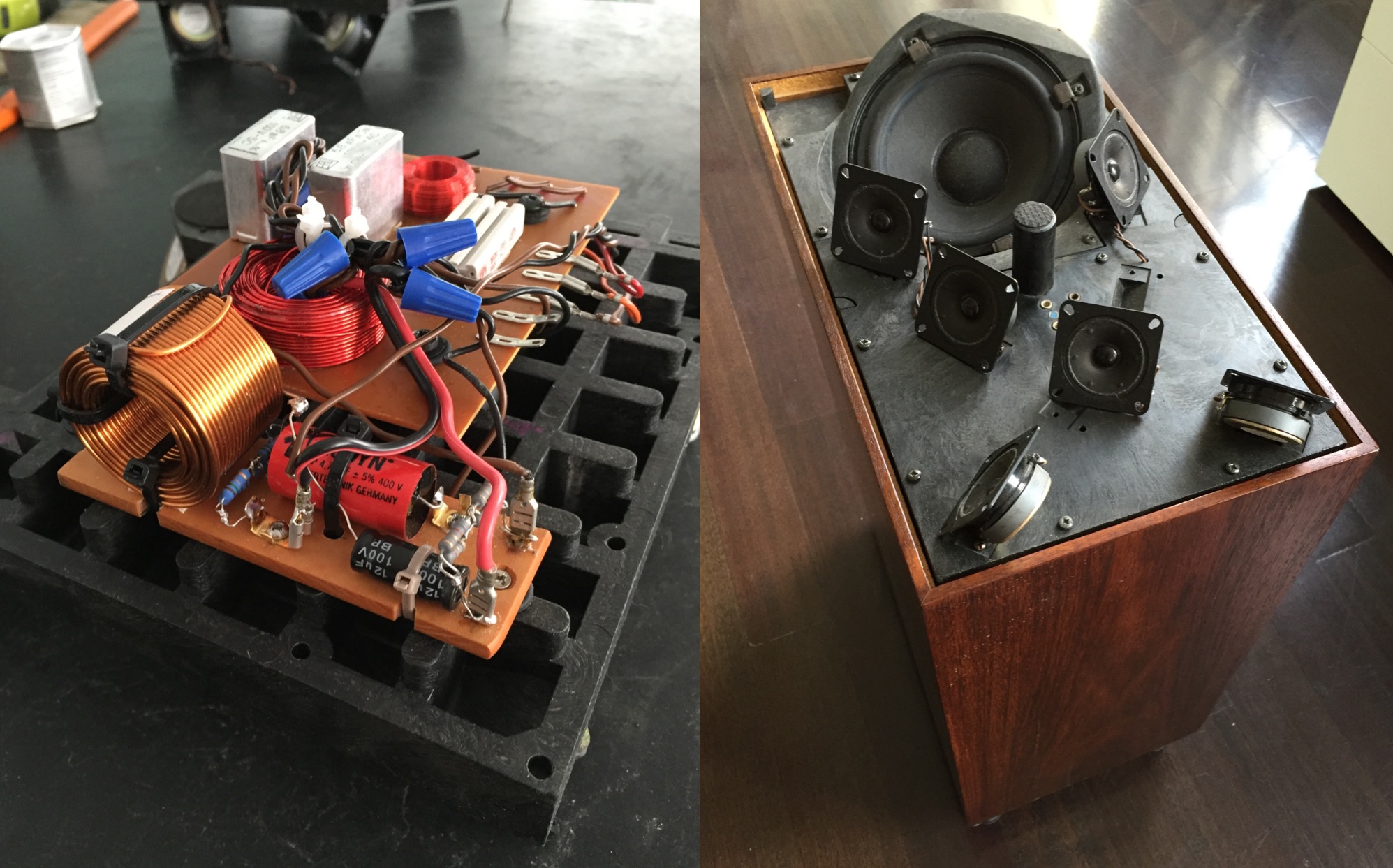

I have been a Sonab fan since I first listened to a pair in a Munich hifi shop in 1976, as a budding teenage audiophile. For years I had OA14s, which were OK. Finally now I have a pair of 116s I am very happy with. This has been a long running project, with a number of stop-and-go periods.
I renewed the woofer and midranges a number of years ago. At the same time I ordered the Peerless tweeters which were then suggested as an upgrade (was it the CT62s?). But I could not find an elegant way to mount them, a way that resembled how the originals were mounted. Then two things happened -- 1. These glue-like plastic rings inside the Peerless's started peeling off, without ever being used (has that happened to anyone else?) and; 2. The upgrade recommendation was now for Obi T22 tweeters with a new crossover.
As I was thinking whether to spend another $400 to buy the Obis, I came across a lot of JAMO 20132 tweeters on sale. They looked a bit like the originals and were ferrofluid cooled. At $2 each I bought 12 (should have bought more...they are gone and on eBay they sell for $20+).
So this is the end product! I built the Obi crossover and fitted it next to the original, which I left in place. I mounted the JAMOs with two cable ties each, one end screwed to the original baffle board -- easy and secure.
So far I like the sound, a lot. It is a bit bright. I bought some 8 ohm L-pads to adjust the tweeter volume down a bit. In any case wanted to share this with the community.

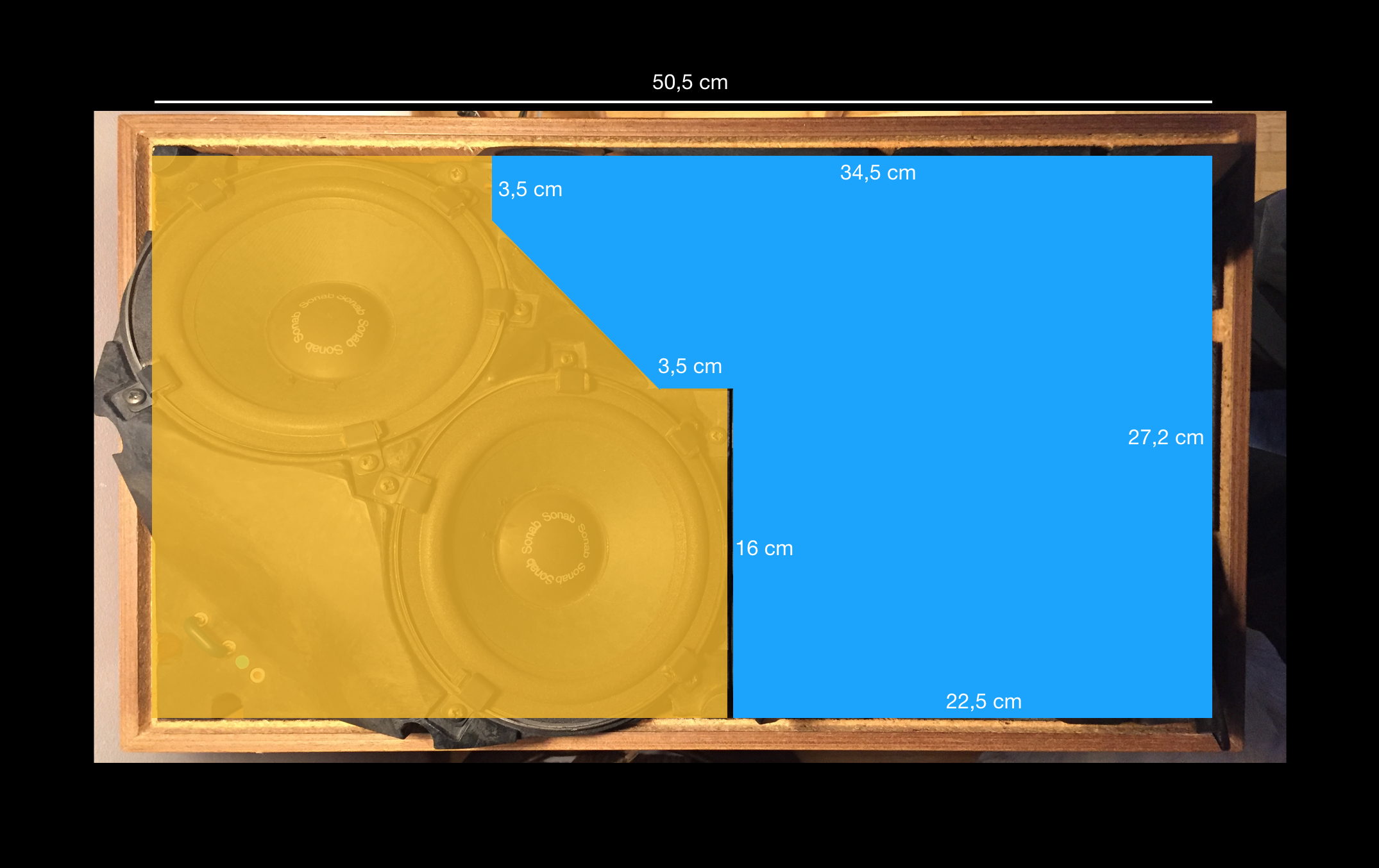

Ok, so i found the old ruler and took some measurements. Mind you, these are close to accurate measurements. I would not bet my life on them being 100%. It was as close as i was able to get without taking them (2212) apart (I am not up for that at the moment).
As you can see the top plate consists of two units. The blue, holding the tweeters is overlapping the orange rectangular shaped unit. The two peaces are mounted to a frame inside the cabinet.

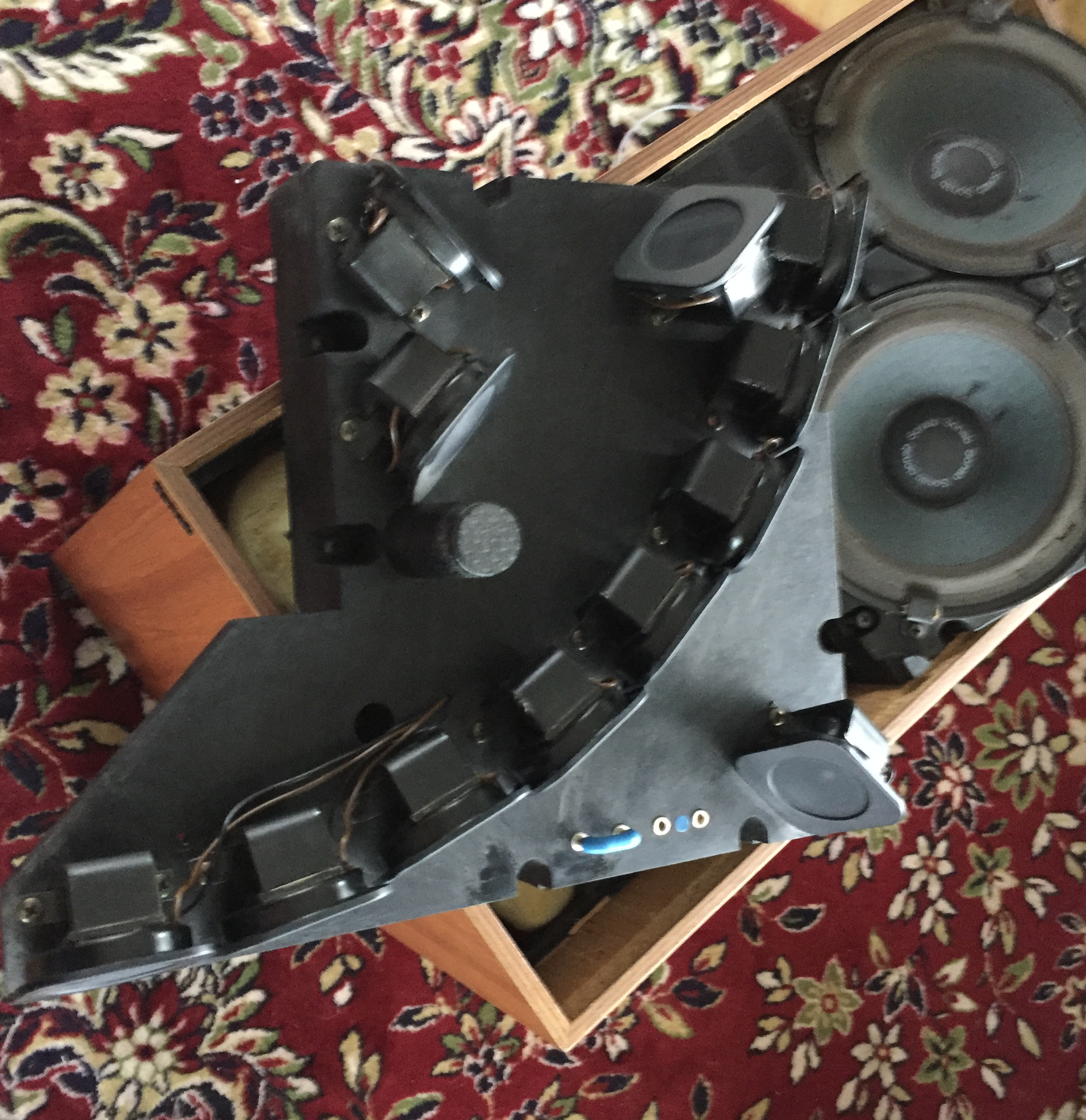

Ill throw in a few shots from when i upgraded the speaker surrounds to give you a better idea of the construction.

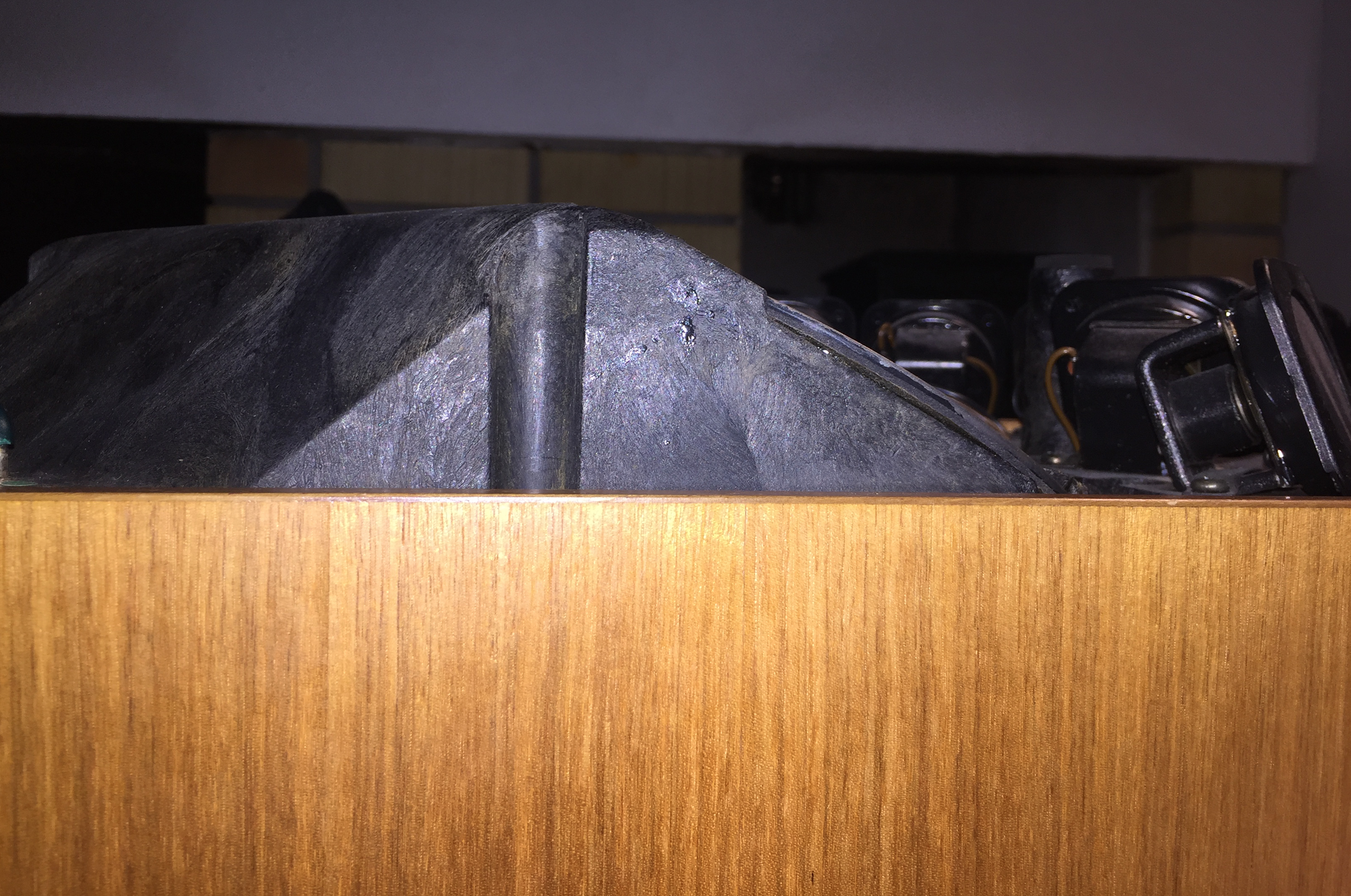

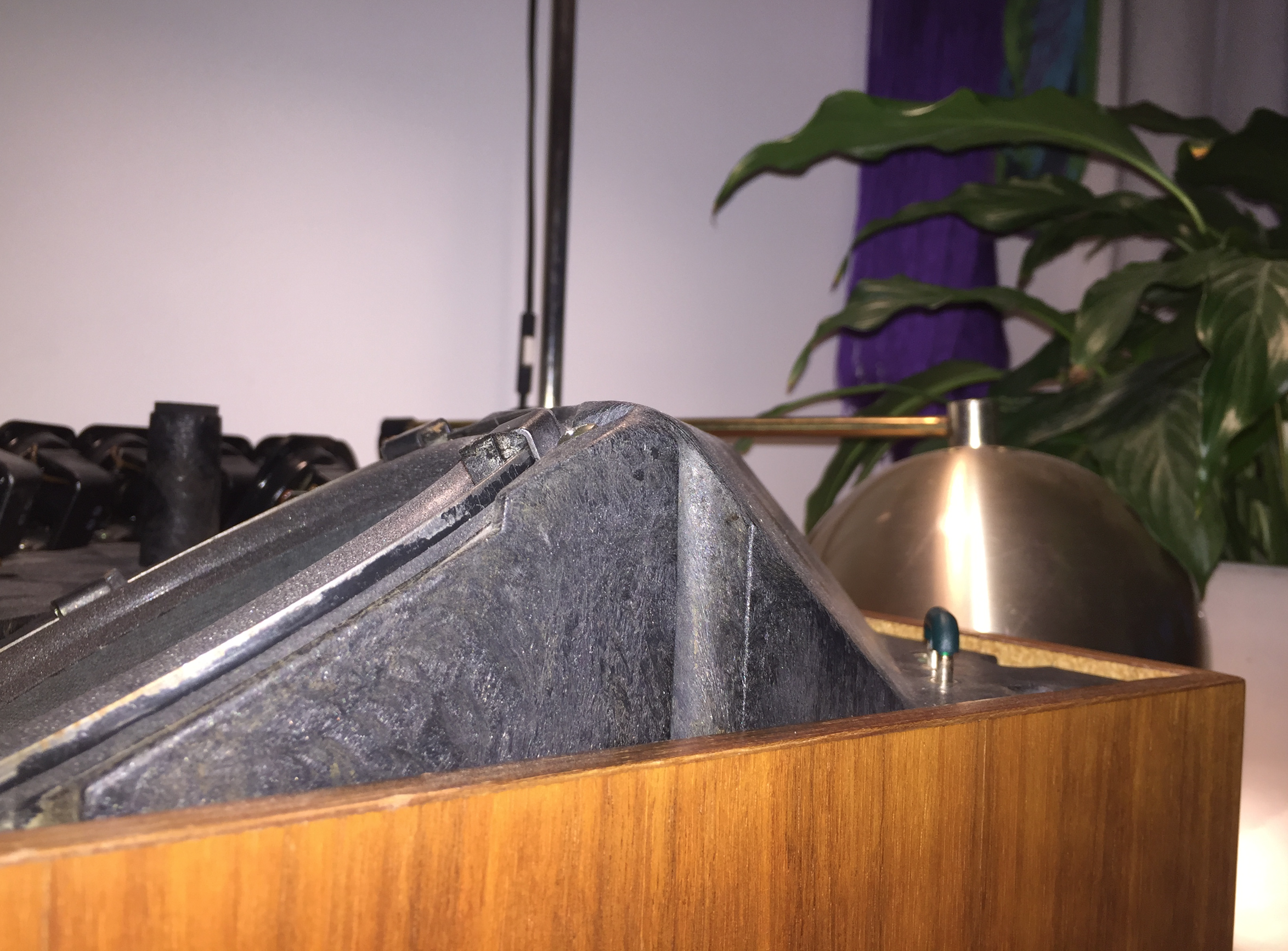

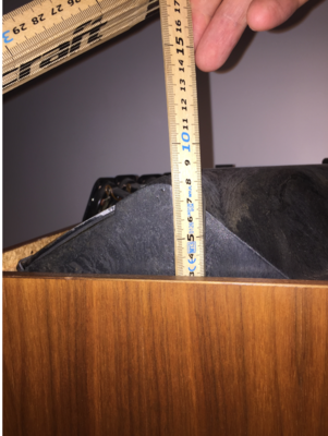

These are fairly straight so you should be able to make out the angles at play.
The one containing the ruler shows the distance from the top of the housing holding the mids, to the head of the mounting screw (if that made any sense).

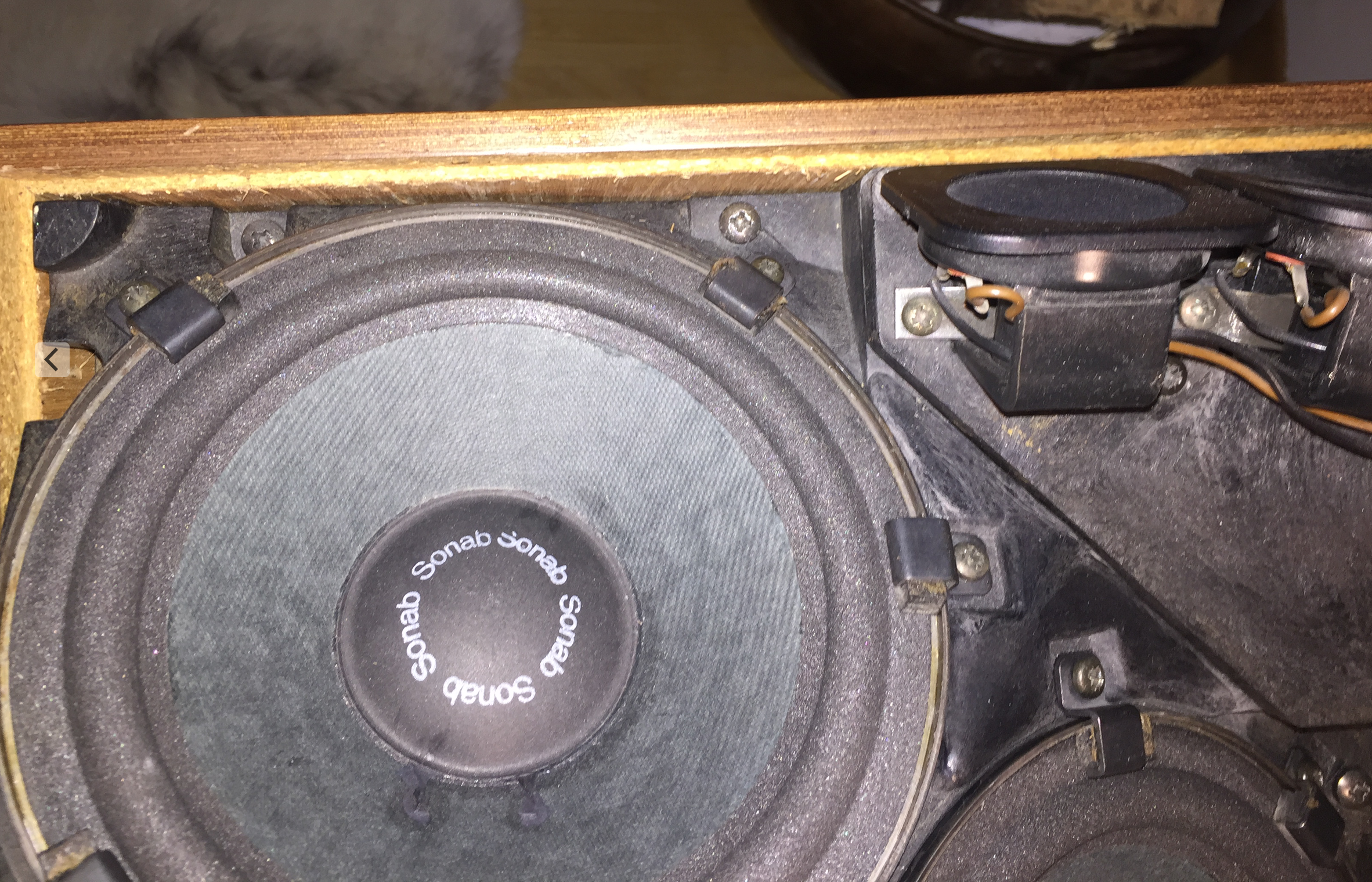

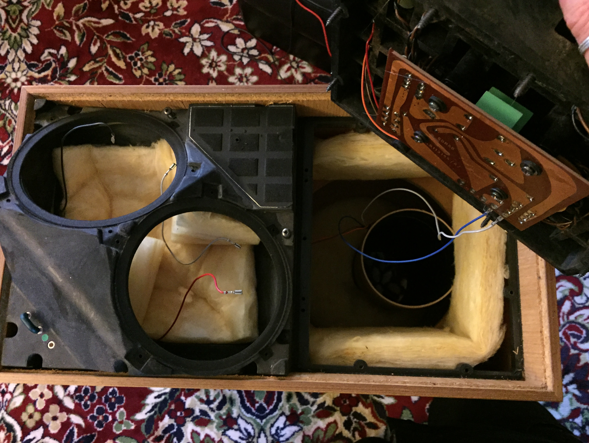

Some more snaps that might give you an idea of the construction. And showing of the new surrounds

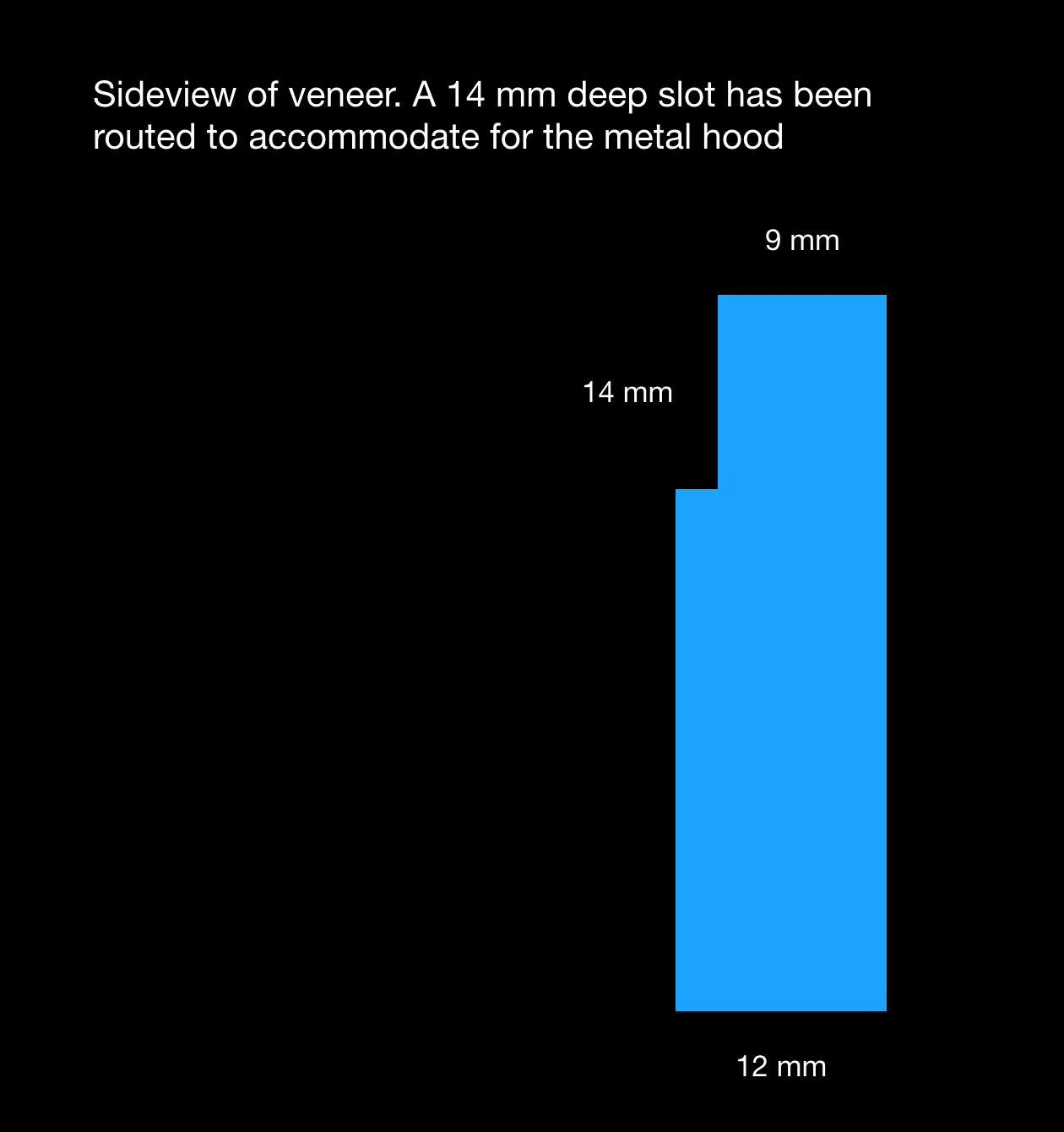

Finally the measurements of the housing.
Hight: 61 cm
depth: 53,5 cm
With: 31 cm
Constructed of 12mm veneer
Hight: 61 cm
depth: 53,5 cm
With: 31 cm
